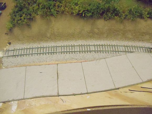

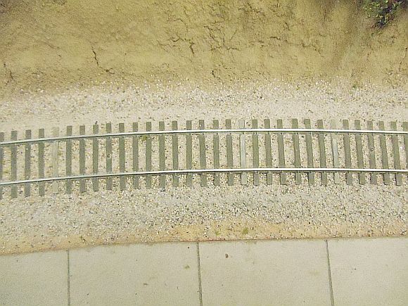

I thought I'd share a technique I do when spreading the ballast. Maybe everyone does it, I'm not sure. In any event if you have done ballast in the past and had it move all over the place, try this. I'll ballast this three foot section. Shown is only 14 inches though.
I'm using Arizona Rock and Mineral ballast. I pour some ballast into a small dixie cup. I fill the cup about 3/4 full. I then pinch the lip to form a small "V" in the rim. I then pour some ballast down the middle and on each side.
I then use a soft brush to spread the ballast along the middle and sides.

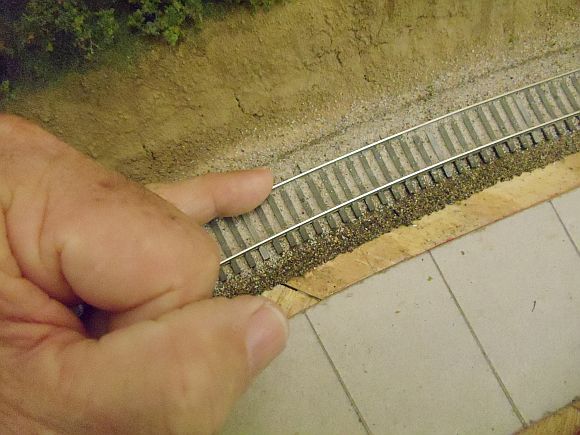

This next technique really gets the ballast down between the rails and makes the ballast look more natural. Only my humble opinion here.
I use my small finger and run it along the top of the ties next to the rails.

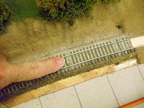

I use my index finger and run it down the middle.
The vibration from my fingers "settle" the ballast nicely between the ties. The ballast settles on the sides as well giving the ballast a nice even balanced look.

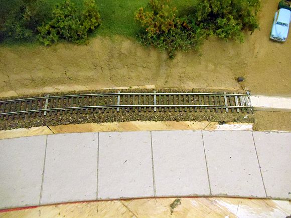

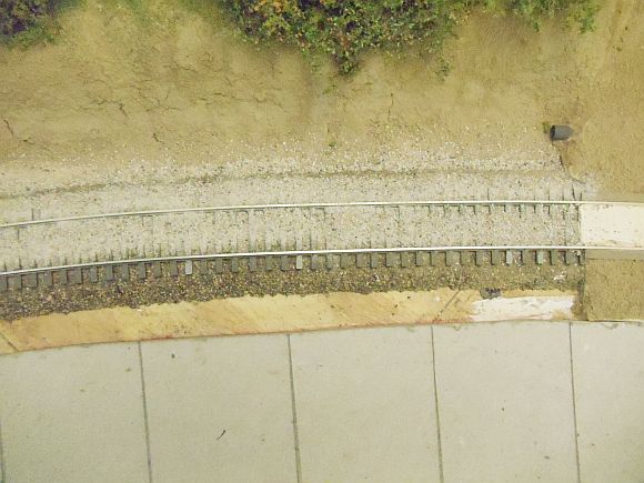

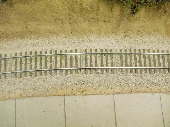

Wet water is used to wet the ballast and then diluted matte medium is used to secure the ballast in place. Here is how it looks when dry.
Notice the little "floaters" on the ties? I use my fingers in the same manner as mentioned above to remove the floaters.
The ballast is nice and even and just below the ties.

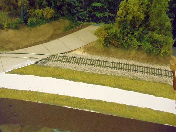

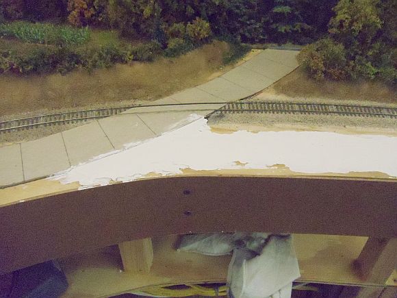

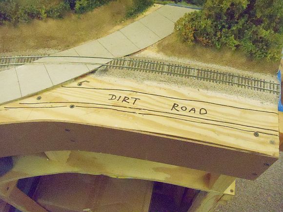

The Judge suggested that perhaps a dirt/sandy road could be added to the right of the highway. This dirt road will in theory lead to the fishing camp on the Suwannee River. This is where the Bascule bridge is located.
I used the DAP spackle for the base of the road.
I glued some basic ground foam and turf on each side of the dirt road. This will be the base for my scrub bushes on each side of the dirt road.

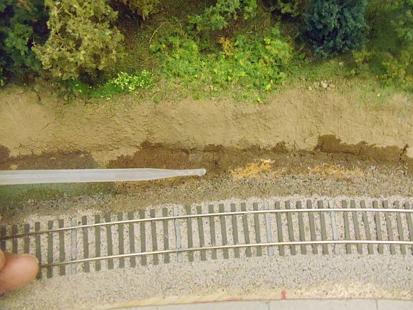

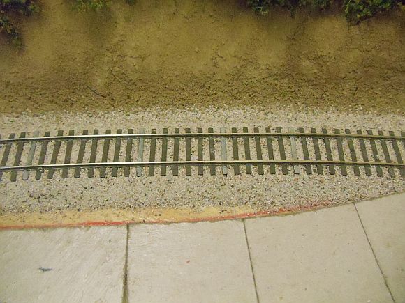

As an after thought, I wanted to mention how I add the wet water to a small section without wanting to "spray" the wet water all over the same area.
I use a plastic pipette to apply the wetting solution. It isn't rocket science but it does work.
After the area is wet, Matte medium and scenery are added.
