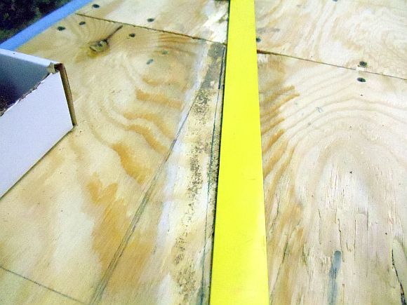

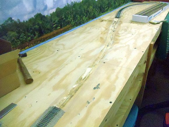

I got the plywood sanded smooth and then realized what went wrong.
In looking at my initial center line, I realized it wasn't straight. I'm not sure how I did it but obviously I wasn't paying attention when gluing the cork to to both sides of the line.
The metal ruler is straight and the black line isn't.

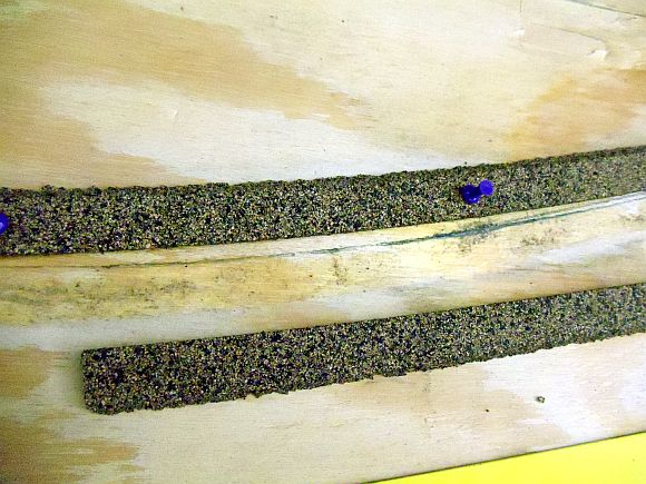

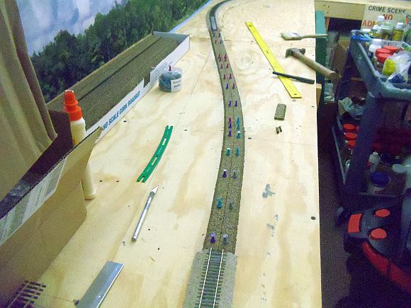

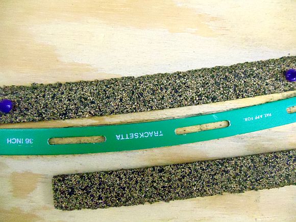

As long as the repair was being made, I decided to change the radius from 36" to 38". In the photo below, you can see the original 36" black radius line. The new cork roadbed is at 38" radius.
I gave myself some transition space on the curve and then used the metal ruler to make sure the line was straight.

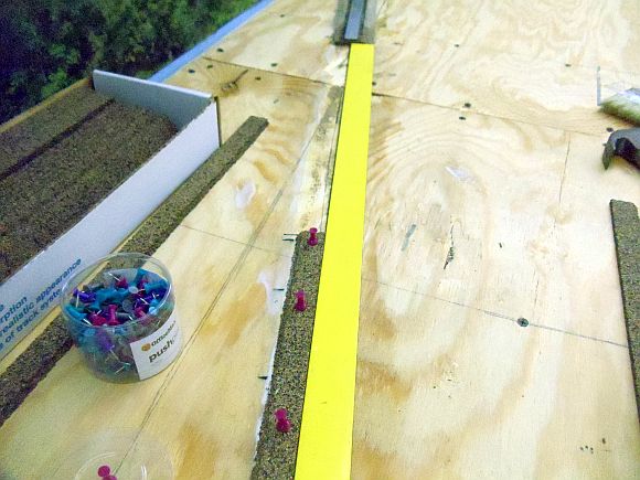

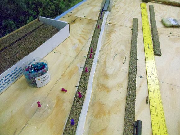

I use the colored push pins to hold the cork as the glue dries.

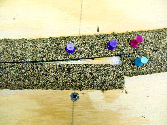

I then cut a piece of cork to fill in the gap making sure the cork was flush against the ruler.

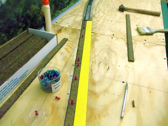

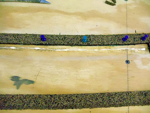

I forgot to mention how I glue the cork to the plywood. It is probably mundane for most but it may be beneficial to some.
I lay a bead of carpenter's glue on the plywood and use my finger to smooth it out or some what flat.
I do this for two reasons. One, it gives you more of a gluing surface for the cork. Secondly, and most important is that if you don't smooth the glue, you run the risk of not getting a flat or flush fit of the cork to the plywood. I've know some modelers who use a small wall paper roller to smooth the cork as it is glued.
NOTE:  If you do use a roller, make sure the cork stays in place. The rolling pin action on the cork, on wet glue will move the cork. In other words, the cork will slide on the wet glue.
What you don't want is some bead of glue drying under the cork and making the cork unlevel.

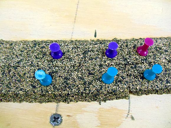

I mentioned using push pins to hold the cork. When gluing the opposite cork piece, I only use the push pins directly across from the other ones.
I do this so I don't push or realign the cork on the one side. I push the cork tight against the other piece at the opposite push pin location and tack it in place with another push pin.
Once all the cork is in place and secure with a gazillion push pins, I let it dry over night.

Your track now has a really nice flow to it.  I'm guessing this will become a favorite spot for railfans.
