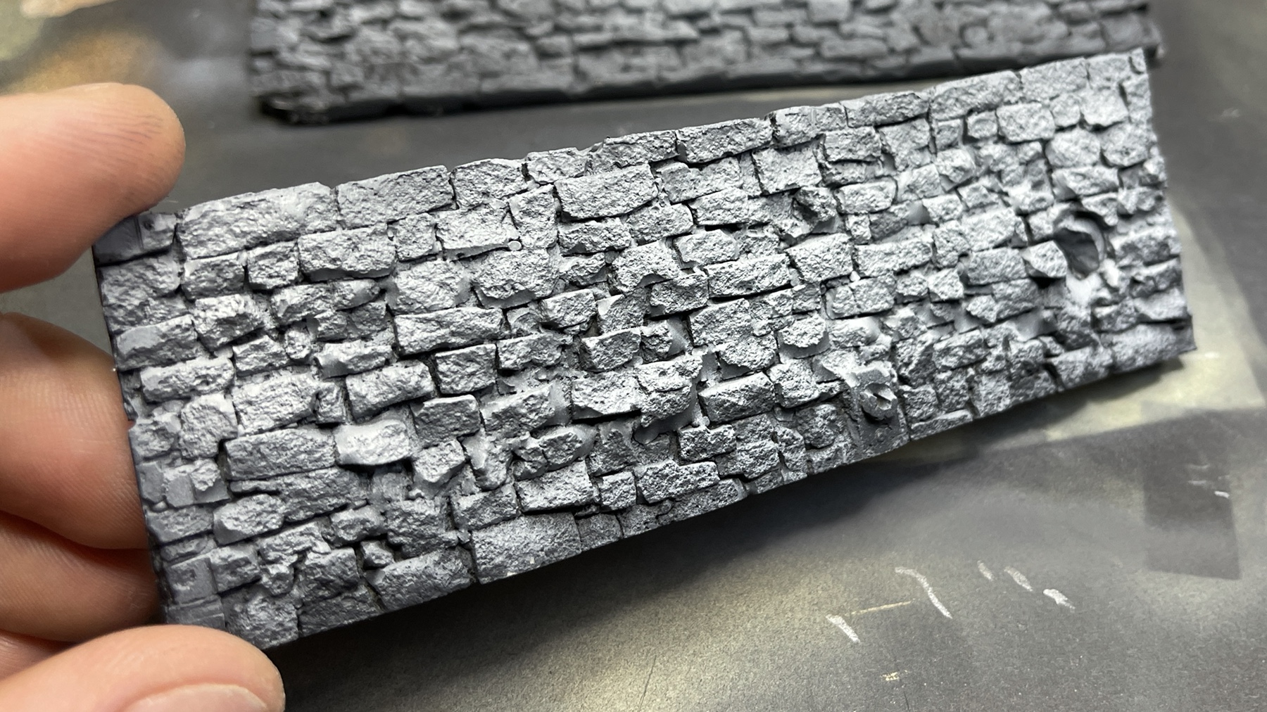

Which mean't some work. So, first things first, I cast and painted my retaining walls. These are the walls from "Cartwright's Machine Shop".
First they were airbrushed with a dark grey, filtering up to a lighter grey to achieve this gradient:

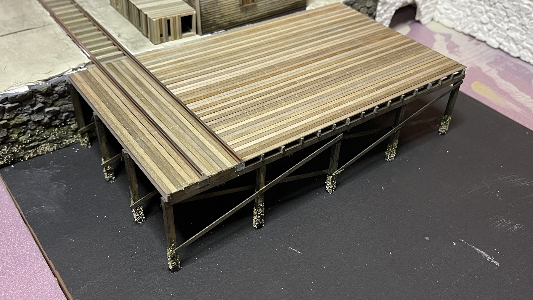

Next up, I finished the wharf (adding the deck planks). I grouped together three bundles of the strip wood, coloring one set with driftwood, the other with Hunterline golden brown and the third set with the standard A&I mix. Then, picking randomly from each pile rendered the below result — pictured after the base was finally made and rail added:

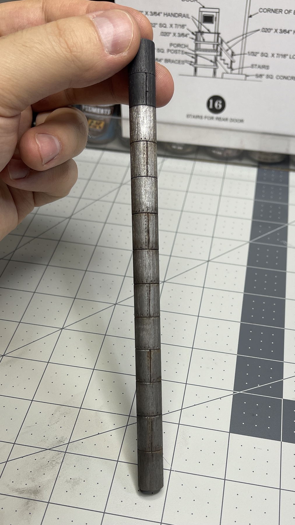

As everything setup and dried, I got to making the large chimney stack. This was, by a country mile, the most difficult part of this kit. It's a 7/16″ wooden dowel that you need to make look metal by scribing horizontal wrapping lines, and straight vertical lines. Performing this task on a rounded piece of wood is no easy feat. And my first effort was a COMPLETE disaster, ruining the included hardwood dowel.
Fortunately, most hardware stores sell dowelling so I easily replaced what was lost — albeit with lesser quality lumber.
Anyway, my first effort was using my mini lathe, so this time I abandoned it and favored a mini pipe cutter. That worked well, so it was on to the vertical lines and more breath holding. To achieve these, I clamped my machinist blocks to the bench and using them as a "back stop", so I could then push the dowel up against them and use my ruler to trap it in place while I scribed my straight lines. I used a panel line tool to achieve these lines. After more finger nails were chewed off, I then got to work punching in all the hundreds of rivets.
Some metallic paints, an oil wash and pastel chalks later, I arrived here:

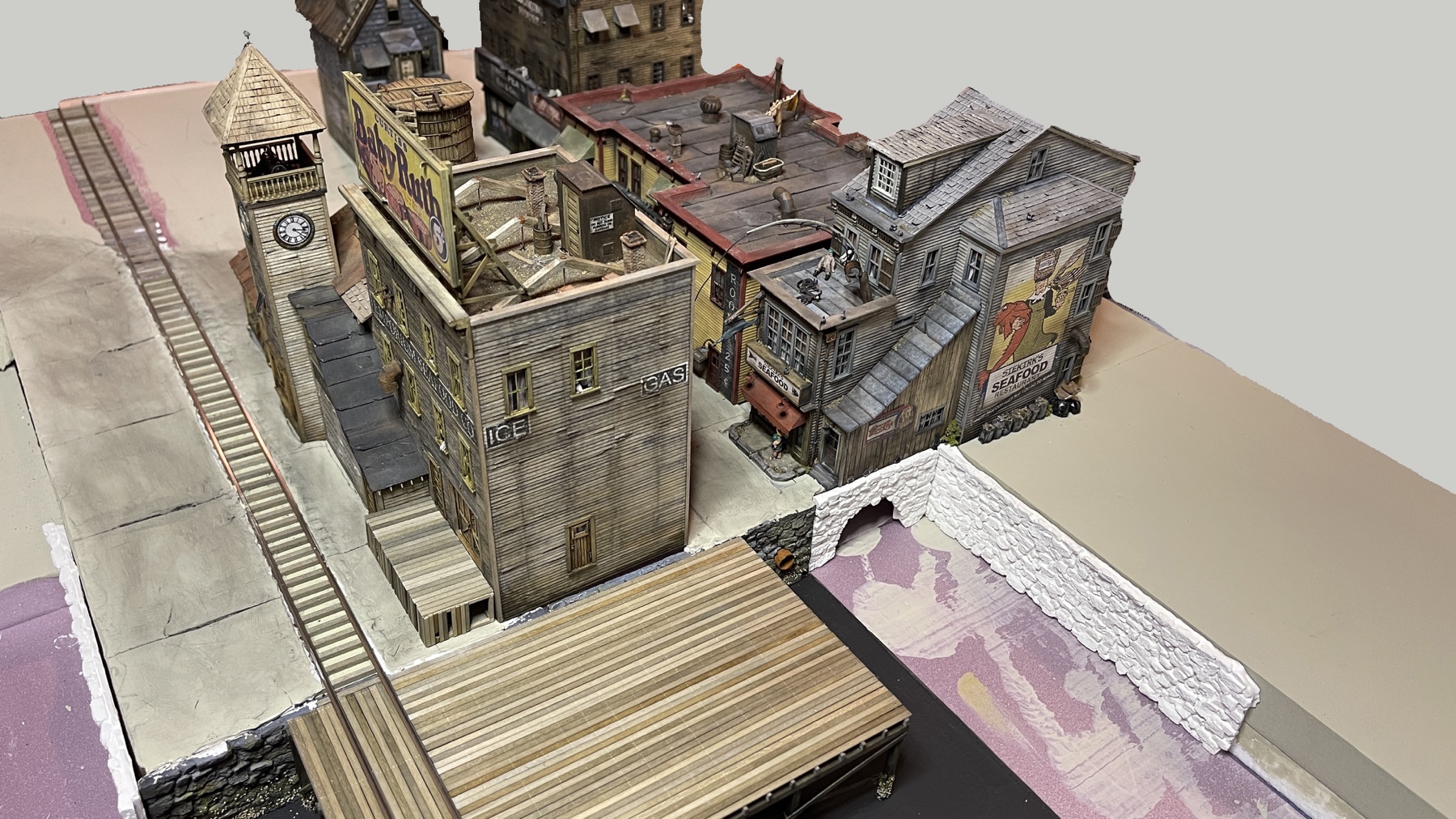

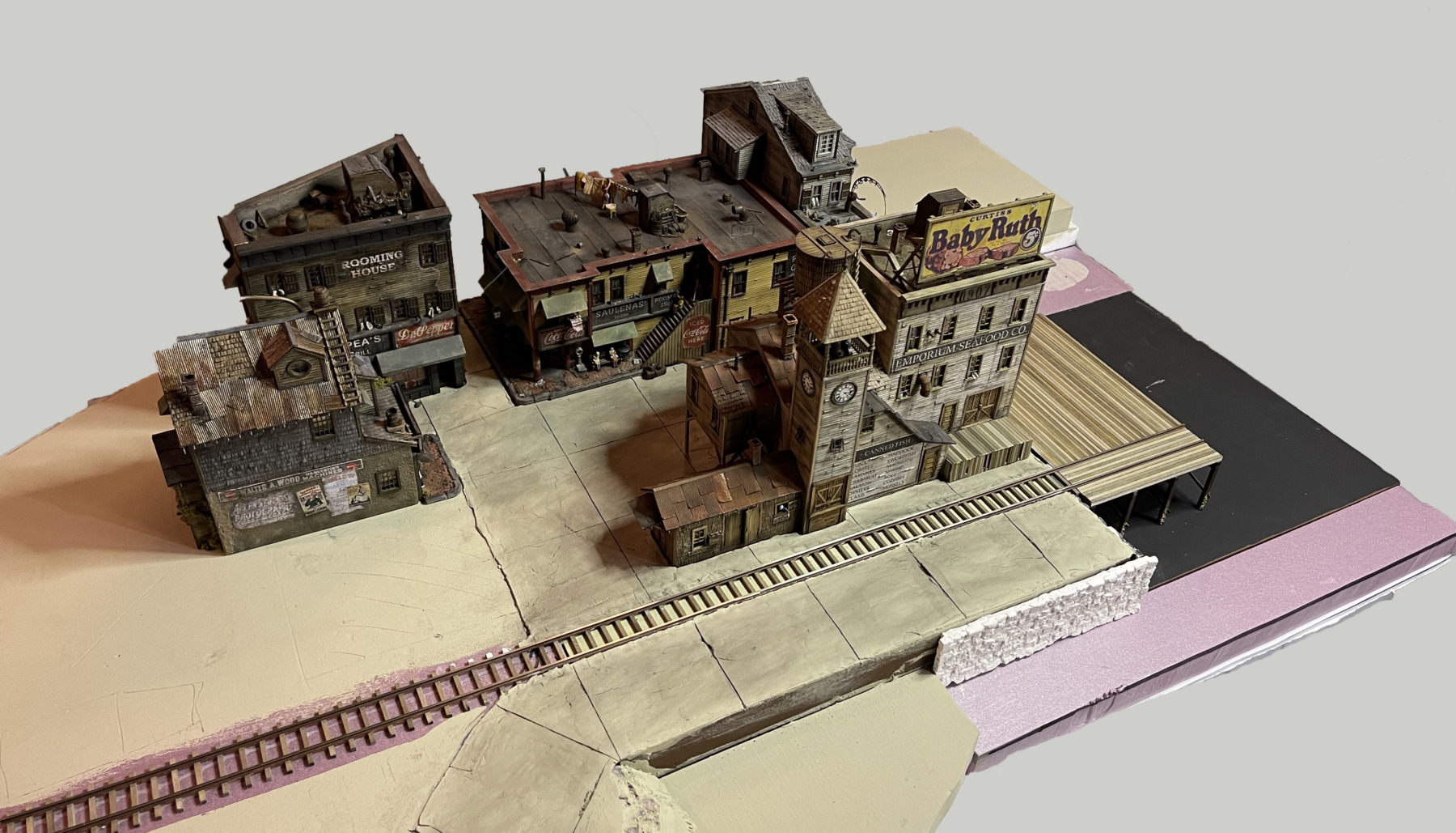

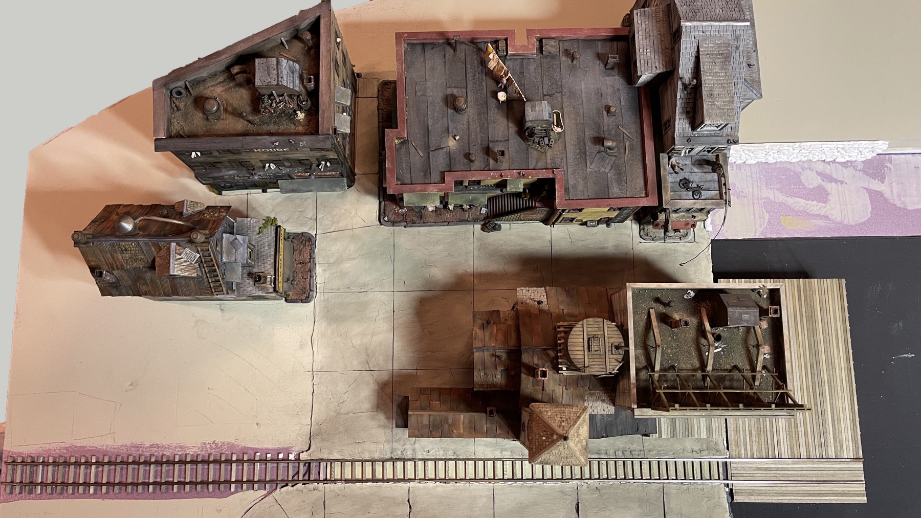

With these details done, I turned my attention back to the base and did a dry fit of everything so I could mark off and make the street. After outlining all the buildings, I removed everything and used, per the instructions, joint compound. George warns you this stuff shrinks and he's not wrong. I came down the next morning and my street had huge, ugly lacerations across it. Whilst I didn't want these, the smaller cracks and to-scale and quite charming. Some filling and drying later, I scribed my expansion blocks, painted a concrete color and weathering using charcoal briquettes.
I put everything back in it's place and grabbed a couple of dry-fit photos:
The whole thing is starting to shape up and it's nice to see it finally configured. It measures approx 35 x 25″, so it's no small potato.
Here is an overview of what I am modeling:
From here, I will continue building the Emporium and then turn my attention to the stone building that George called the "FSM Casting Building" — although mine will be called differently 🙂
