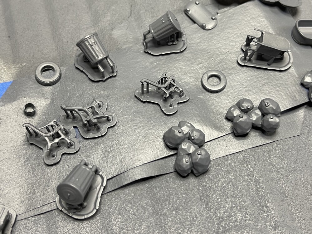

As 3D printing is all about using up as much build plate space as possible (printing time is affected by height, not object quantity) I put together a bunch of designs I've either designed myself or collected from websites such as Thingiverse or Sketchfab. I primed these prints with the storefront:
Most of these details will be added once the structure is complete and the tribute diorama as a whole begins to come together.

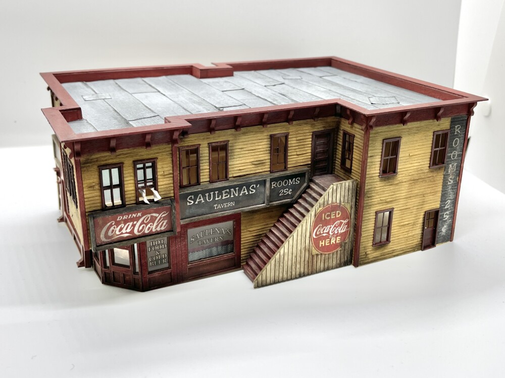

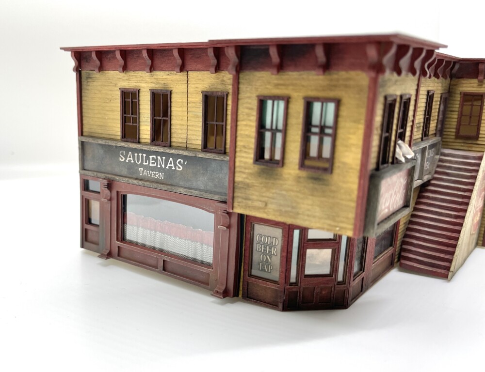

I went over the entire structure lifting clapboards with my x-acto and adding chalk pastels, adding a fair amount of weathering.
Finally, I painted and fit the storefronts from the Bar Mills kit (again, this is beauty of taking a kit and modding it) and that's brought me to the following state:
I still have lots to do — and feel like I've only just broken the back of this awesome build.
