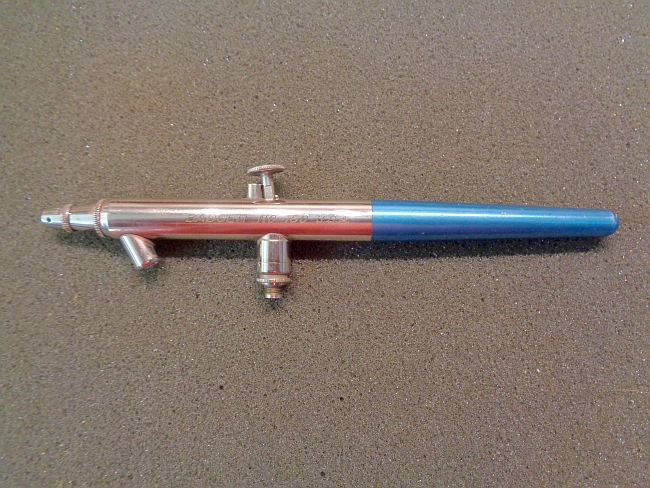

I taped off both cabooses that needed to be touched up paint wise. When I got out the compressor and spray hose, I found a leak in the air hose. It was loosing enough air so I couldn't use that one spray gun.
A friend gave me a Badger spray gun with a compressor and air hose. So, I decided to use that one.
Let me just save some time and say that the Badger spray gun was nasty with lots of dried paint on the outside and inside.
I completely unassembled the gun, removed all the dried paint and after three hours, reassembled it. I didn't think to take any before photos, but here is the spray gun after a complete cleaning.
I used it to spray the touch up Signal Red on the two cabooses. I won't use this on e again but will keep it as a back up.
I've used a Binks spray  gun for the past 50+ years. I'll get a new hose and move on.

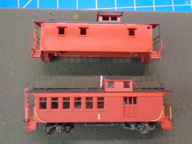

Now I can add the A&S to the #1 caboose and decals for the one on top.
As I mentioned, these have been on the work bench for at least prior to my heart surgery back in 2021.

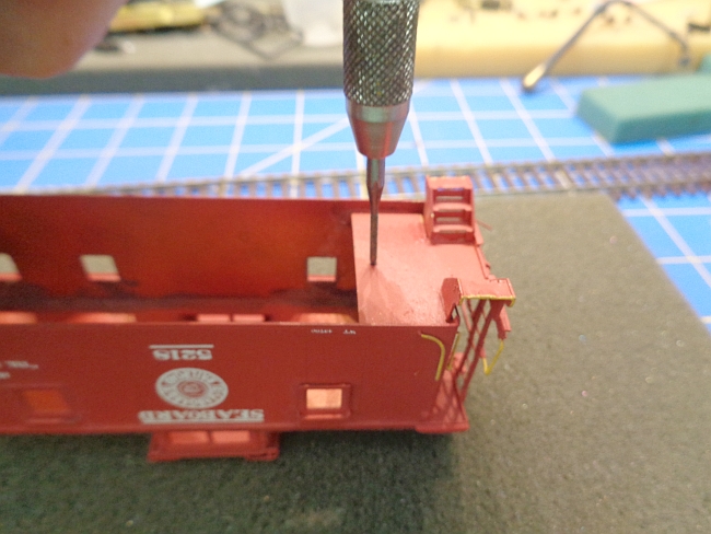

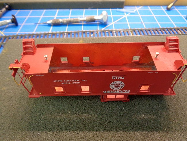

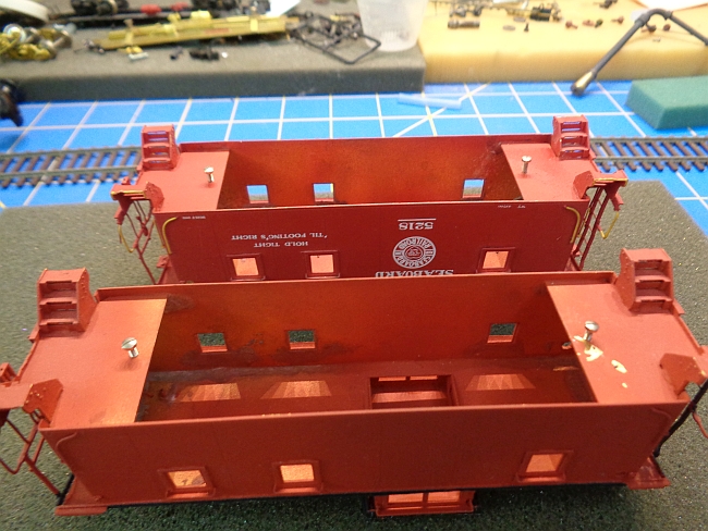

I have no idea what happened to the screws that hold the bottom on two of the cabeese. Nor could I find the coupler pocket screws.
When I was professionally painting brass back in the late 70 - 80's, there were times I had to removed brass plates, make new ones in order to install PFM Analog sound. To do this I had to drill and tap new screw holes.
This is what I did to the two cabeese here.

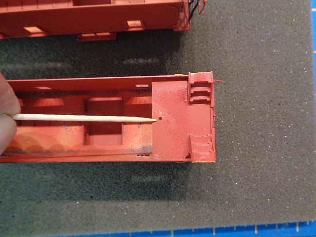

The small hole shown in the next photo is a 1.2 mm hole.
I used a 1.4mm tap a made a new hole for the 1.4mm screw.
When tapping new holes in brass, patience and carefully use of the tap is required.

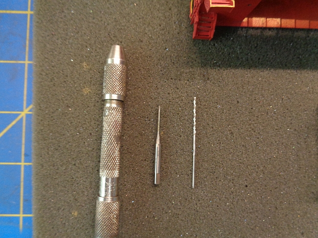

The next photo shows the three tools used for tapping a new 1.4mm hole.
The small drill on the right is a 1.1mm drill bit. It wasn't necessary for me to use the bit.
The 1.4mm tap is in the center and the hand held drill is on the left.

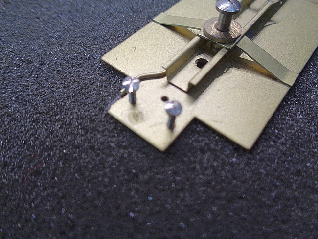

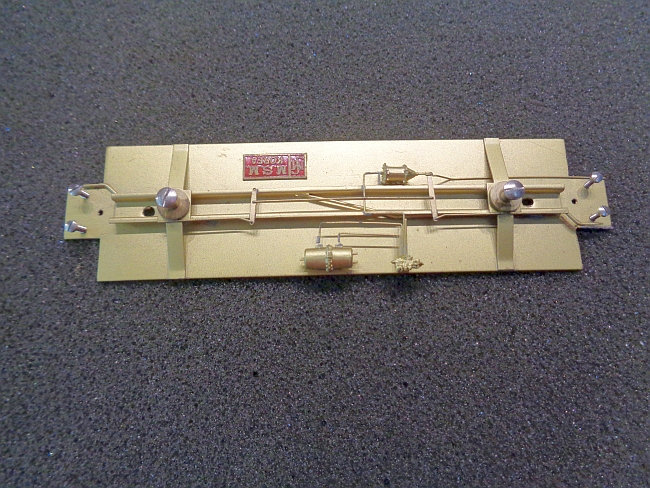

I inserted the tap in the hand held vise and carefully tapped a new 1.4mm hole in the caboose bottom plate. When tapping a new hole the tap is twisted right and when finished you just can't pull it out. You need to slowly and carefully back it out by twisting it left as it backs out.

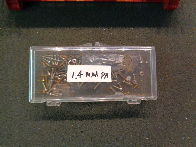

Now I have new 1.4mm screws for the two caboose bottom plates.
A good, cheap way to get itty-bitty metric screws in multiple sizes is to look for eyeglass repair sets.
I also tapped new holes for the coupler pocket screws.

Quote from: deemery on July 28, 2025, 04:33:08 PMA good, cheap way to get itty-bitty metric screws in multiple sizes is to look for eyeglass repair sets.
Yes, you are correct and I have used eyeglass repair tiny screws on brass locos.
Great comment.
