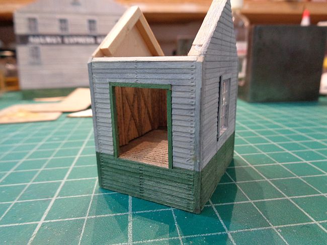

I needed the sub assembly to fit flush against the main structure. I made a back wall out of spare stock to fit between the two corner trim boards. I also made the a roof support for the rear so the roof panel will be level.
Since I scratch built the small addition and made it slightly larger, I needed to then recut the roof panel to fit the new size.
The one shown below is the original roof panel. I forgot to take a photo of the new roof panel.
There is a small structure that fits under the main roof of the freight house. Since I cut new walls for the main building and the small sub assembly, the kit clapboard walls for this small one don't match.
Shown below are the kit walls and where it fits on the kit.
The next photo shows the kit walls on the top and the new ones I cut on the bottom.

I decided to add interior details to the warehouse. This also made me aware that interior walls and a floor needed to be added to the kit.
I used 1/16" X 1/32" scribed siding for the interior walls.
I used the kit walls as a template and drew the bay door openings on the wall section. The walls were then cut along the lines as shown below.
The first wall section was glued in place and weights were added and set over night as the glue dried.
I forgot to mention that I allowed a 1/16" gap at the bottom of the interior wall. This is where the floor will fit.
