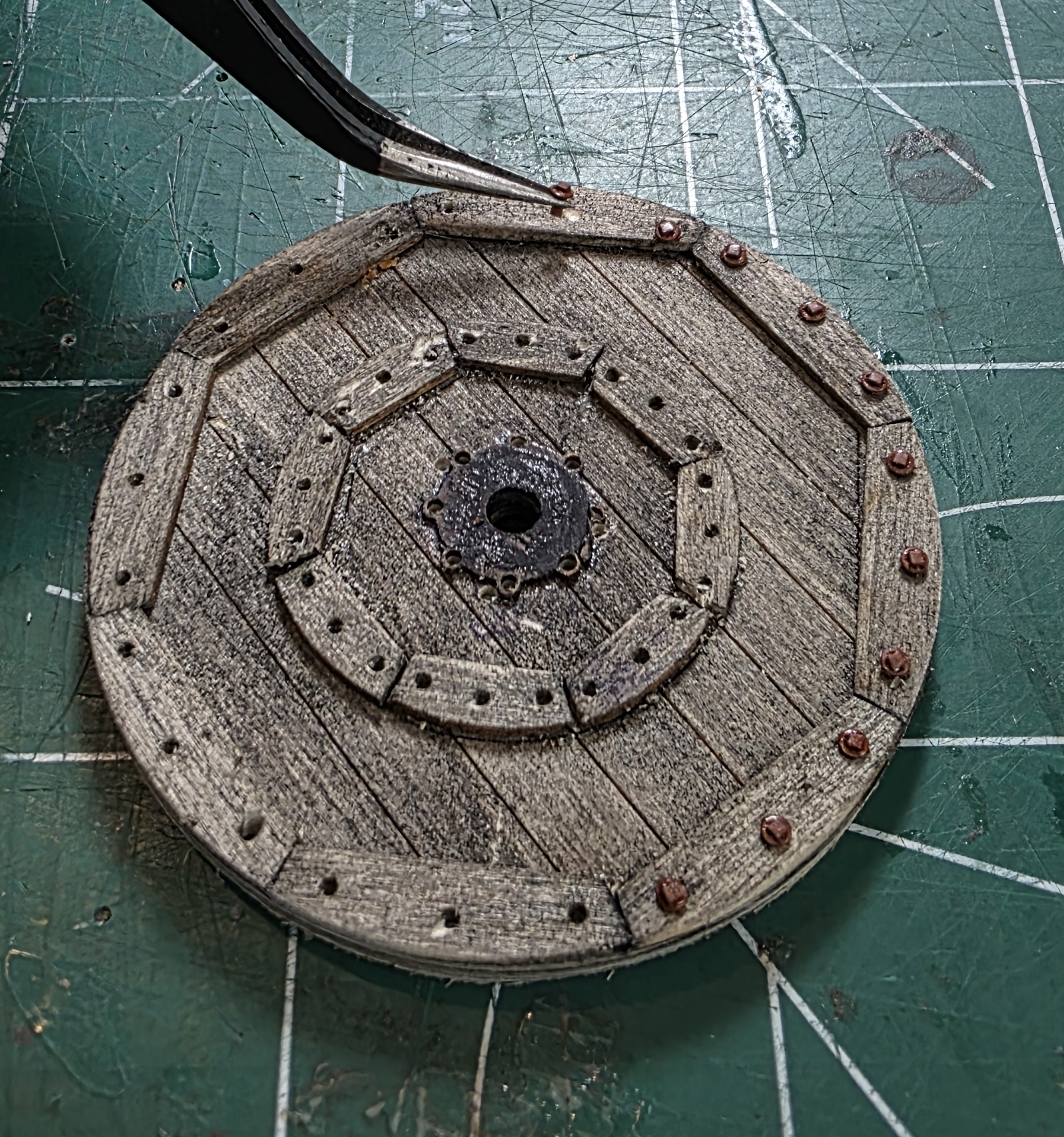

 See all those little holes?  Guess what goes in them.

Thankfully, I only had four NBWs sprout wings and litter the floor, but I have many more to plant before I'm done. I drilled holes in the wheels deeper and larger to facilitate easy insertion.  It worked, but it is still tedious.  Today I ran out of painted NBWs, so that gave me a break from wearing 2.50+ diopter reading glasses.
The drill press with a foot pedal made the process less difficult.
This insertion process works well for me.

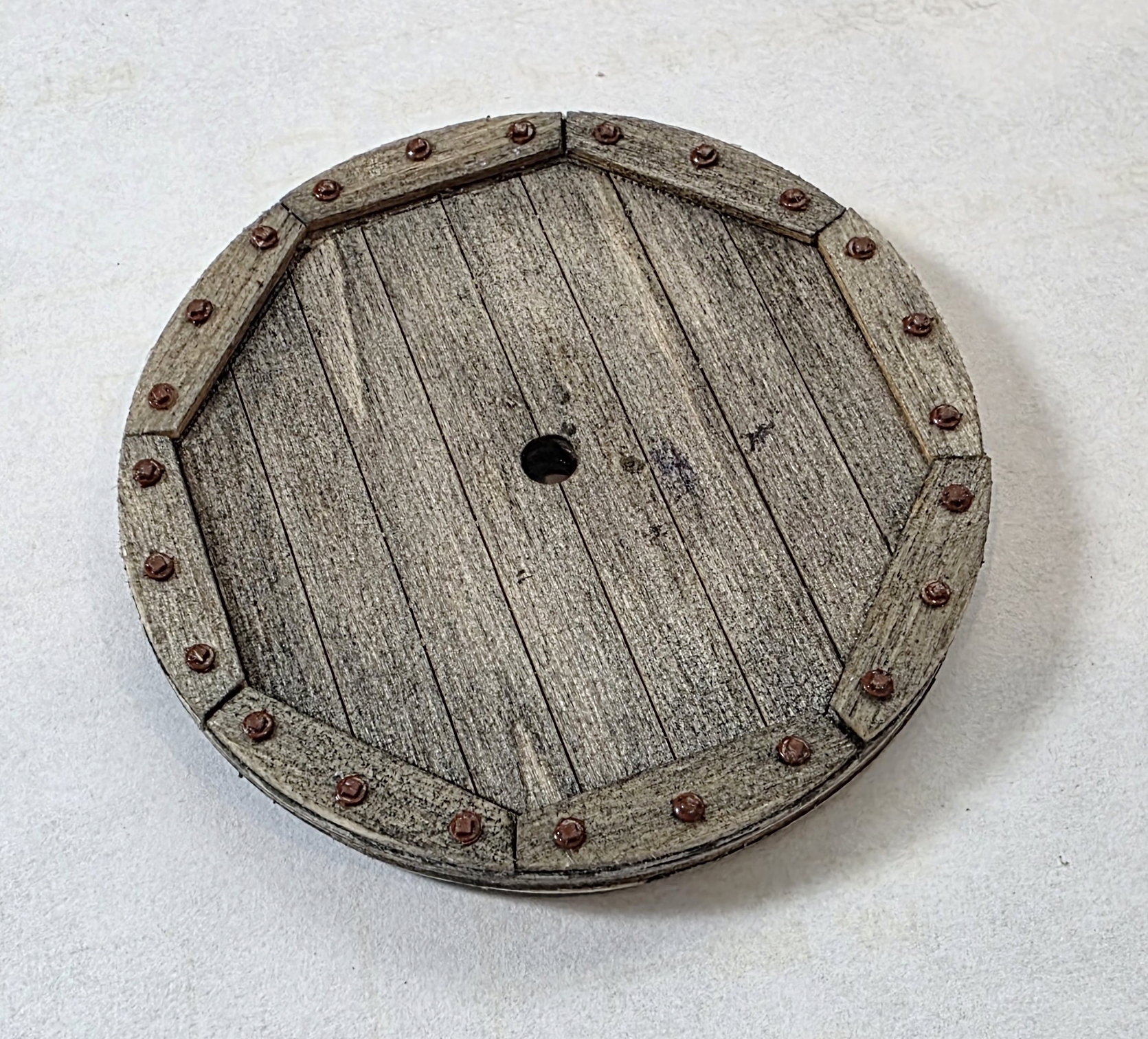

The first wheel is finished, with four more to go. Here's the front and back.
A little weathering and this wheel will be ready to mount.
(The late) Craig Bisgeier and I visited Bernie Kempinski's layout.  Bernie put us to work, I was tasked with doing NBWs in a water wheel.  I think my loss rate (O scale NBWs) was still about 20%.  I blamed Bernie's tweezers.  :o

Howdy Dave, tweezers make all the difference, so you are blameless. Have fun, mike

Mike,
I looked several pages back, and I couldn't find what you used
to paint/stain the wooden wheels with, they look great.
Rich
Quote from: Pennman on November 23, 2025, 04:04:56 PMMike,
Rich
Howdy Rich. I use 99% alcohol, black and brown India ink and black pigment from Dr. Bens.  I have no idea of the ratios. I added drops of color until I got the shade I liked.  I use the same stuff on all of my exterior wood models.  Have fun, mike

Great looking work on the wheels and the NBW's. I found using a toothpick with a dab of wax from a (new) toilet wax ring works really well for installing the NBW's in their little holes.
