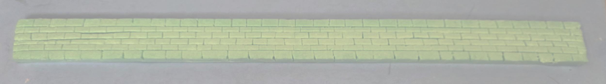

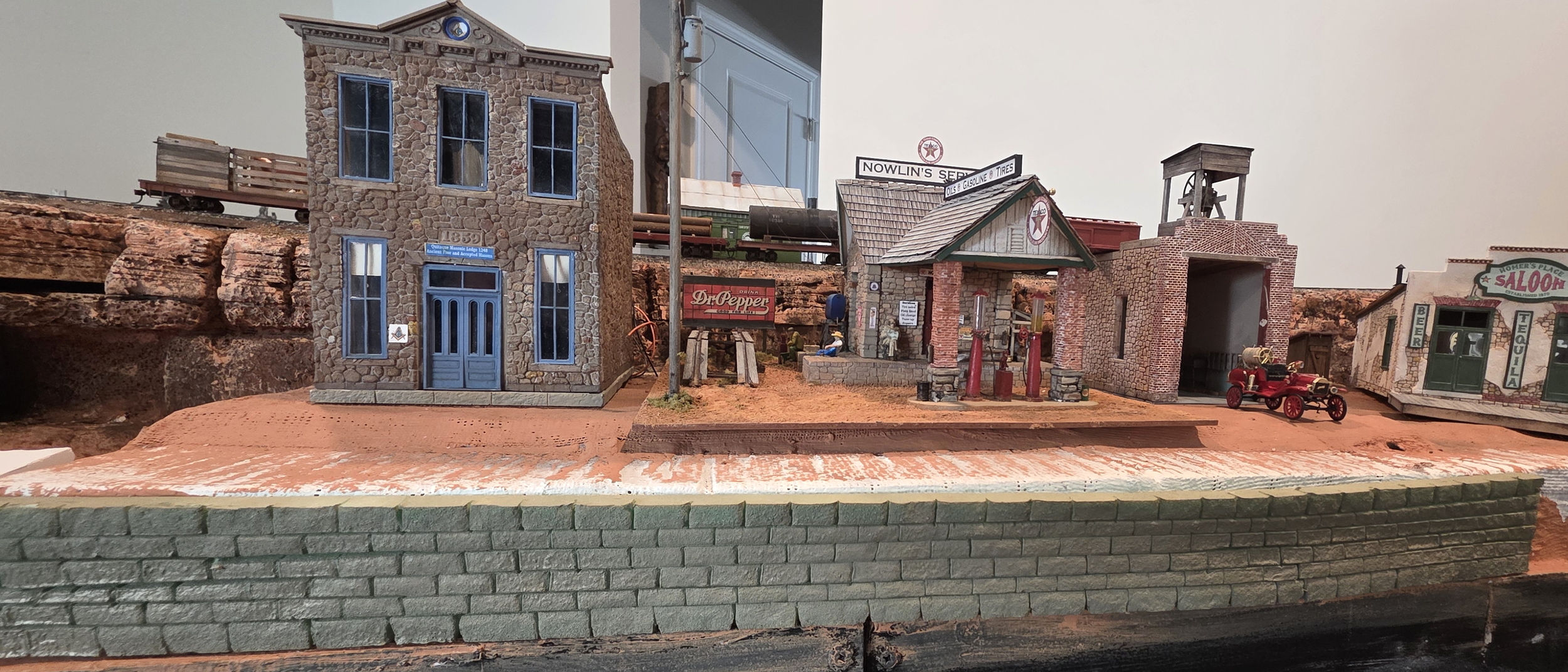

I finished the three sections of stone retaining wall that lines Main Street. A base coat of primer was applied and when dry, I'll start the tedious stone coloring process.
The retaining walls were made from EPS foam and are 2" H X 1: thick.  I used an exacto blade to cut the stone outlines, then used a pencil to widen the cuts.
I haven't decided on the color of the mortar yet but the stones will be painted like the bridge abutments.
Stone wall cut and ready for paint.
The stone wall was tacked in place for the photo. It is painted with a tan base coat.
Next will be the railroad tie retaining wall across from the derrick.
Mike, that wall looks very good.

Mike the retaining wall is great!!

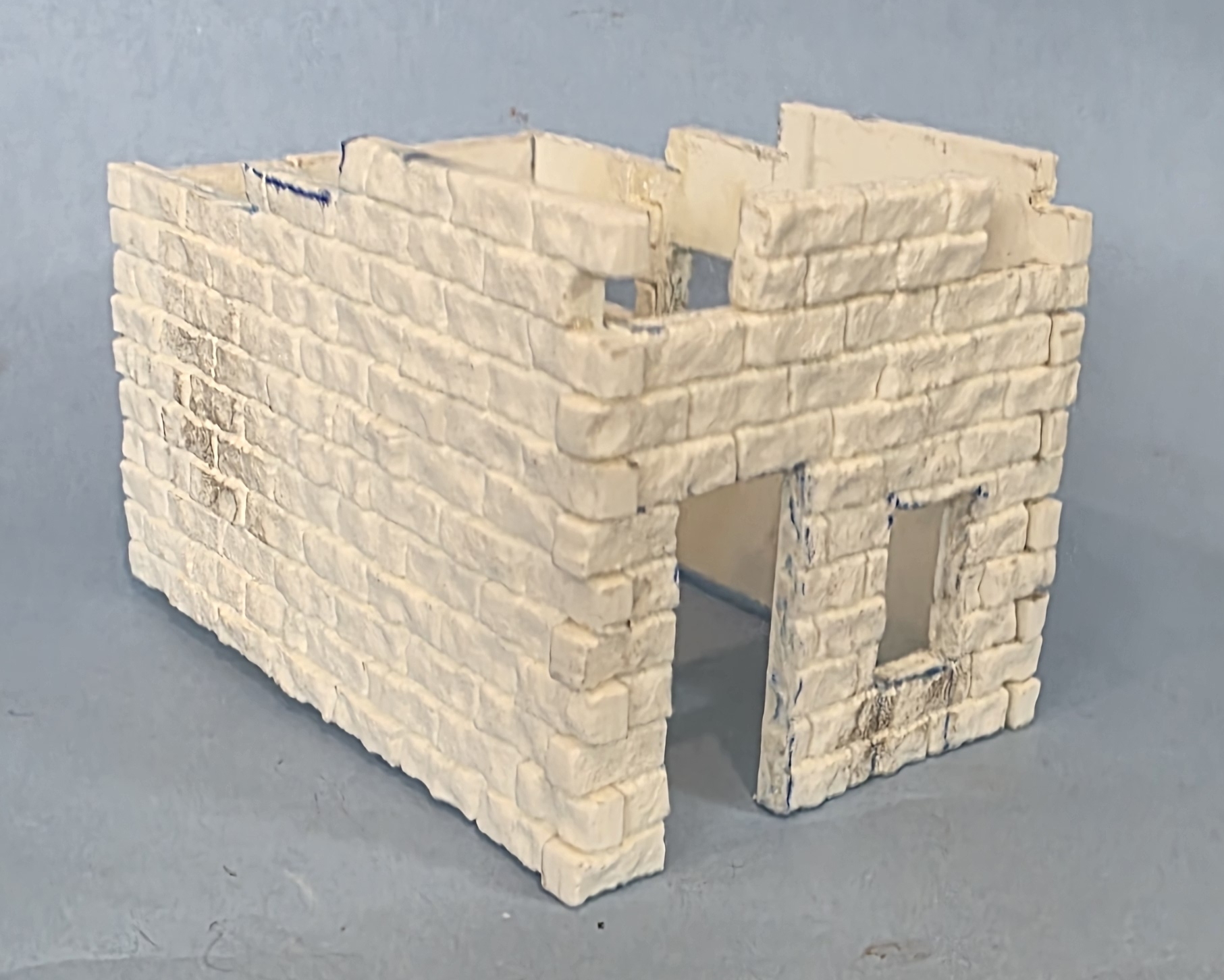

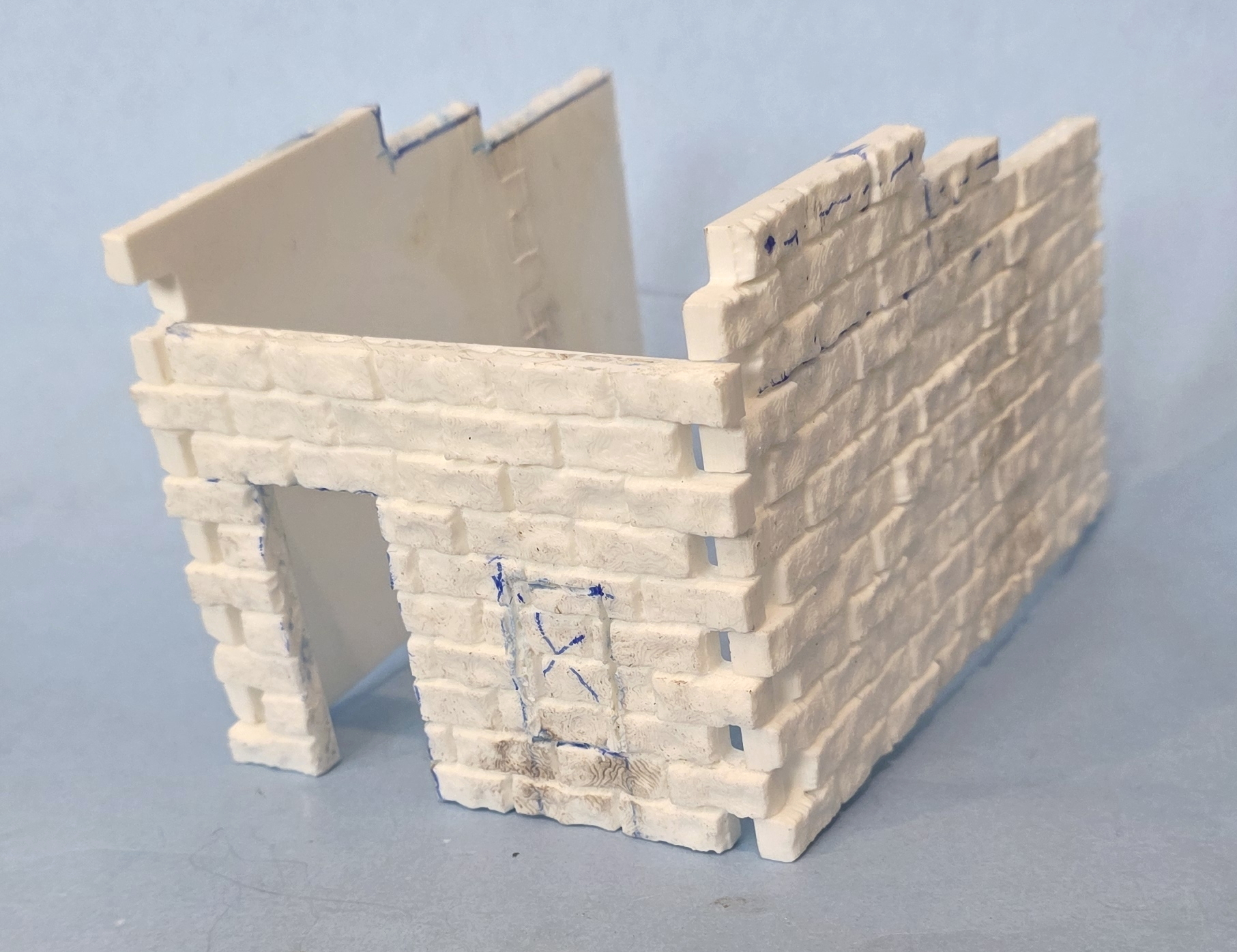

The walls for the sheriff's office have been cut out except for the windows in front and on the side.  It is proving to be a little tricky to cut out in the hard PLA print.  Had I not been so anxious to try out the stone prints, I would have printed the window and door openings.  Oh well, next time.
Here is a photo of three walls to give you an idea of the look.
Next, I'll cut out the windows for the jail cells.  I have the Tichy bars ready to go to keep the town drunks in captivity.

The sheriff's office is glued together.  When the glue is dry, I'll use plastic putty to fill in the joints.  Then it's a good scrubbing before priming. The stones will be a light rusty tan color with dark mortar, similar to the other stone buildings in Quitaque.
