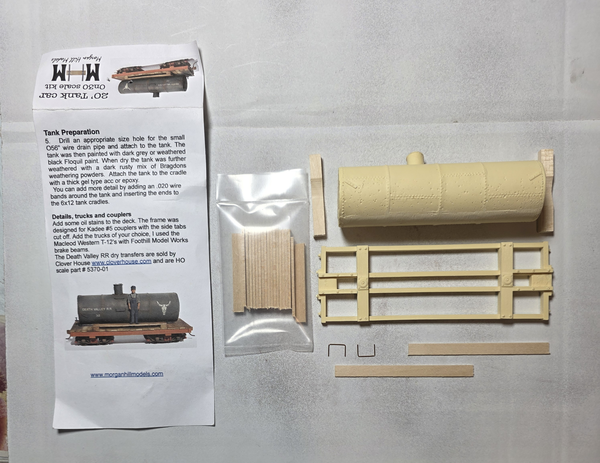

Next up is a simple kit from Morgan Hill Models, a 20' tank car.
Morgan Hill Models marketing photo
The package contents

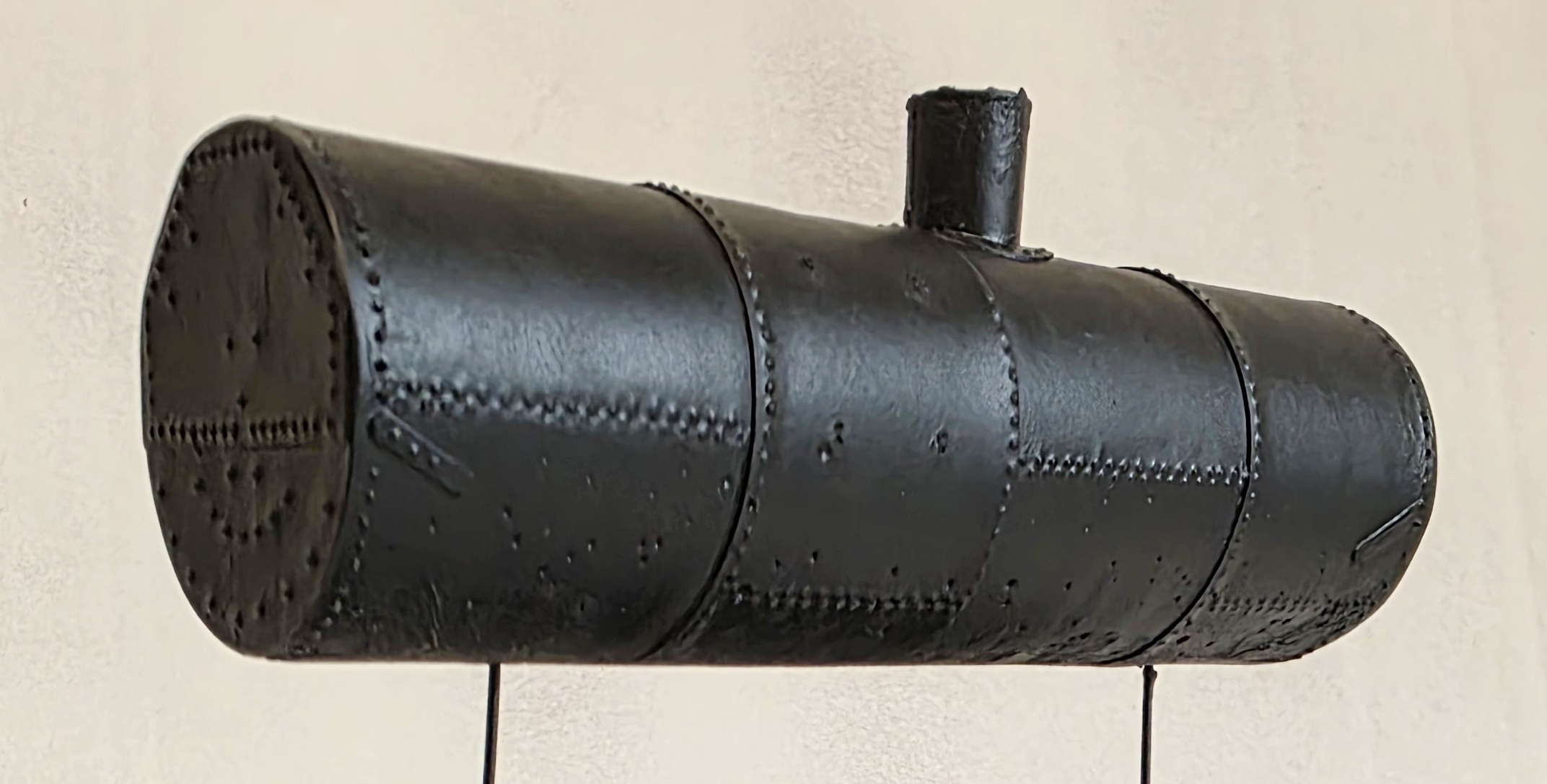

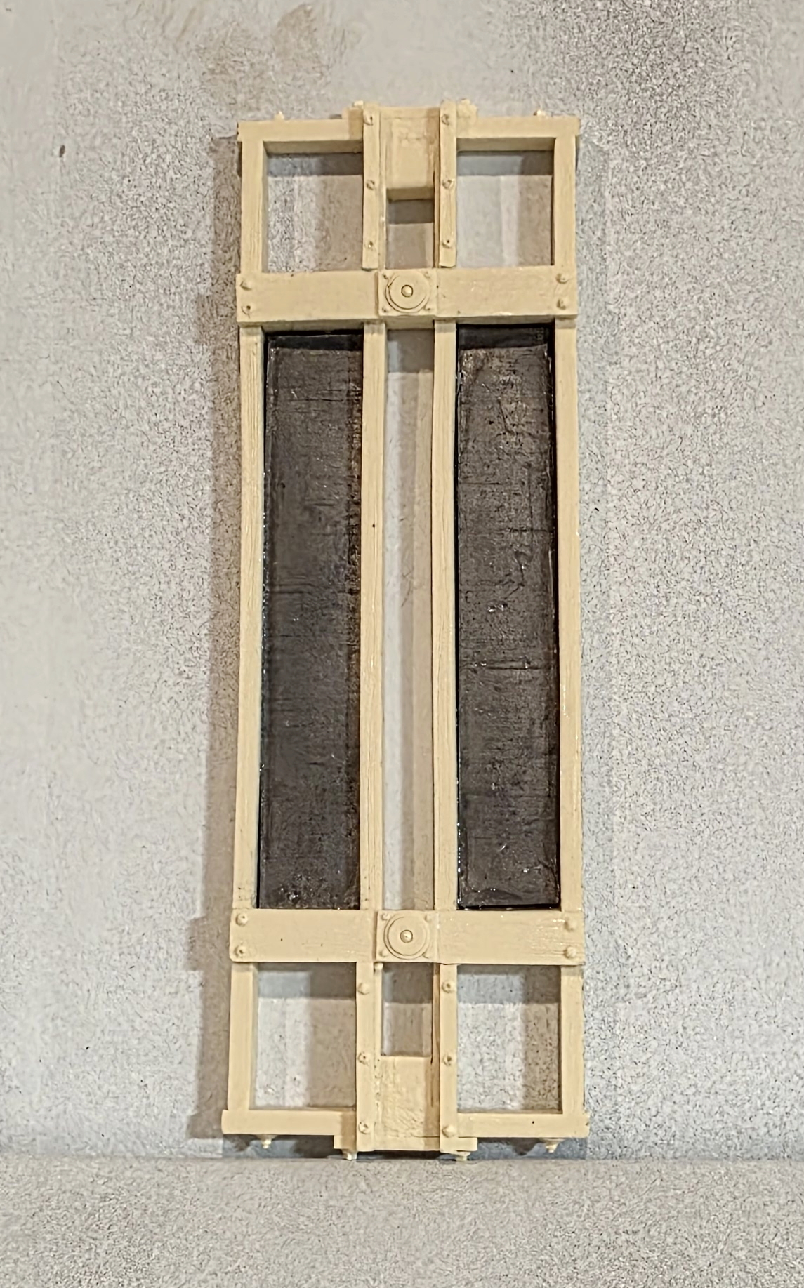

The tank car frame got lead sheet weights, and the tank got a couple of coats of black.  I didn't add much lead because the tank is heavy.
Frame with weights.
The tank is ready for grabs and weathering.

Mike, what's the diameter and length of that tank? (real inches).  Is it a 1-piece casting?  Resin?
Quote from: deemery on April 07, 2025, 06:39:57 PMMike, what's the diameter and length of that tank? (real inches).  Is it a 1-piece casting?  Resin?
Howdy Dave,
The tank is made from resin and is 4.164" long with a diameter of 1.545".

I could use -3- of those, if anyone knows a source!!!!  (They'd work for horizontal stills for my 1890s era HO refinery.)
The frame and tank look very well done.
