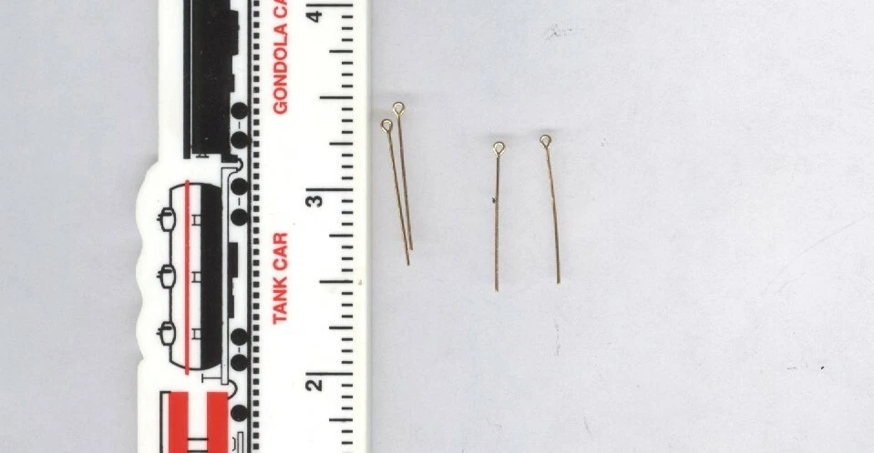

Pennman
Let's talk about scratchbuilding and about how I made one of my own details.
For this update, I must make a swivel hook and a lower hook with a chain for the swing beam. That attaches to the steel I-Beam at the end of the stone building.
On the right side in the first picture, is the swing beam on the kit model and a swivel hook and chain. I will describe how I made the swivel hook and chain.
When I scratchbuild, I must either make details or buy from online shops.
Basically, I am a packrat when I save items from discarded tools, printers, etc. and
use them in my modeling to fashion details and detail parts. On one of the forums,
some years ago, I saw someone using watch parts to use in making details. I searched
online, and found some on Ebay. I have been using them for saw blades, and gears for
several years now. They can be seen in the second picture.
I also purchased some tiny brass eyelets / pins from a friend on Ebay. Third picture.
I snipped the end off one of the small watch parts that had a pre-drilled hole in the end. I used AK Metal Burnishing fluid to blacken it. I cut the ends off two tiny brass eye pins. I cut an 18 inch (in HO scale) section of round, wooden dowel rod and drilled both ends with a 70 (.0280) drill bit. I then superglued the two hooks into the dowel, one on each end.  Fourth picture.
I waited for the glue to dry and then painted the hooks and swivel. Fifth picture.
Last picture shows the completed swivel beam with hooks and chain attached.
I was happy with the way this turned out and glad that I could make one without buying it.
That's all for today, thanks for watching.
Rich
