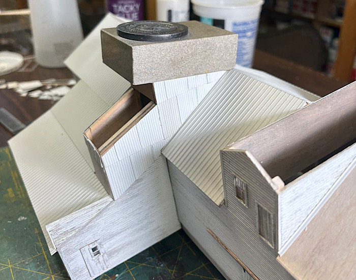

Sometimes I forget about chimneys until after the roof is done; what a pain then.  This time I remembered, and built a little platform for it to sit on, nice and plumb:
The chimney is a Tichy part, painted a brick color. After placing the subroof, I added mortar by slathering on a light gray-colored powder mixed with isopropyl alchohol:
After it dried, I wiped off the excess on the brick with a wet (spit) finger:

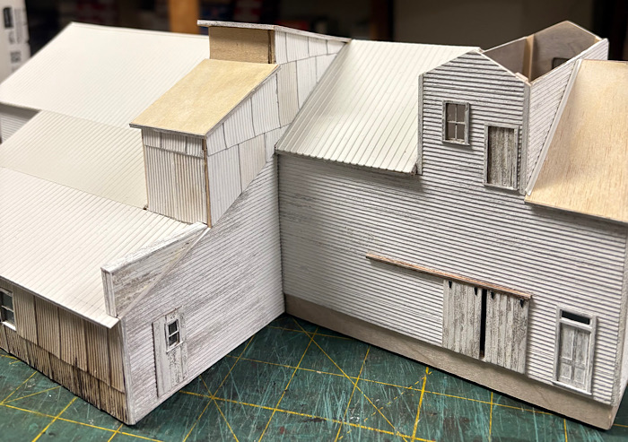

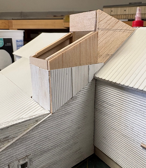

I added more metal siding, row by row.  Here's an early stage:
I finished the metal; time to add roofs.  First, a subroof::
Trim was added around the perimeters.
Both of these small roofs are ready for the styrene "metal" roofing.
