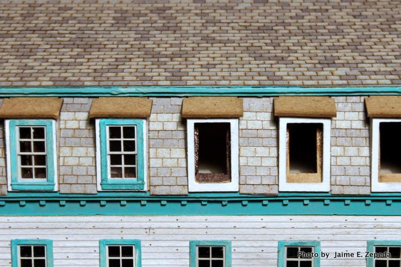

Here come the dormer windows.
There is nothing too special about how the dormer windows go on. They fit perfectly and I glued them in with Pacer Formula 560 canopy glue.
I did want to point out one thing.

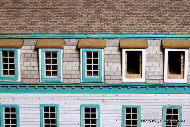

First take a look at how a dormer looks without its window.

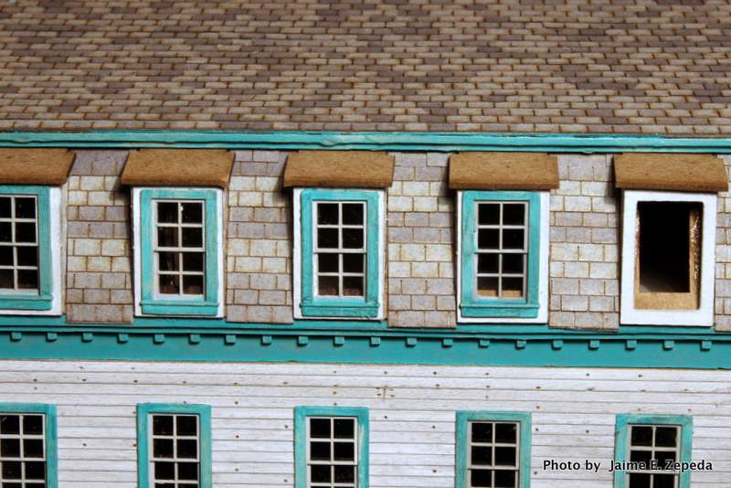

Now take a peek after adding the dormer window.
Did you see that?
The mansard roof form (chipboard) shows through the window. It is not a big deal. But, it was bugging me. So, I blacked out the chipboard behind the window.
And now see if you can tell the difference.
It is really not necessary to do what I just showed you. But I wanted to do it and it did not take long to do so I did it.

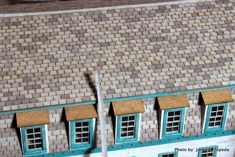

Here is an overall look.
Did I mention already there are 80 windows?

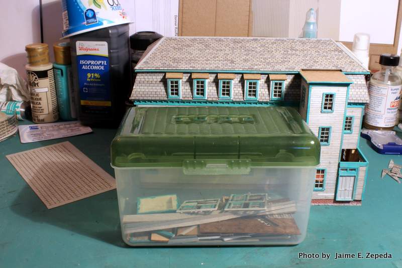

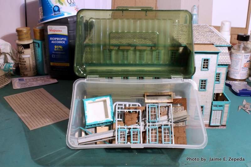

I thought I'd mention how I try to keep track of all the little bits and bobs needed during the build. I try to find a small container where I can store all the small parts that are needed as the instructions call for them. I also throw in the small container any extra pieces of stripwood and the like in case I can use them later in the build as shims or bracing or what-have-you. It is very important not to throw away any of the spare shingling as you never know when you will need it.
Thanks for tagging along.

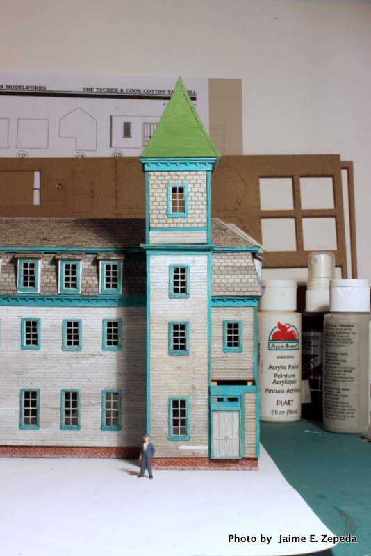

Here comes the tower.

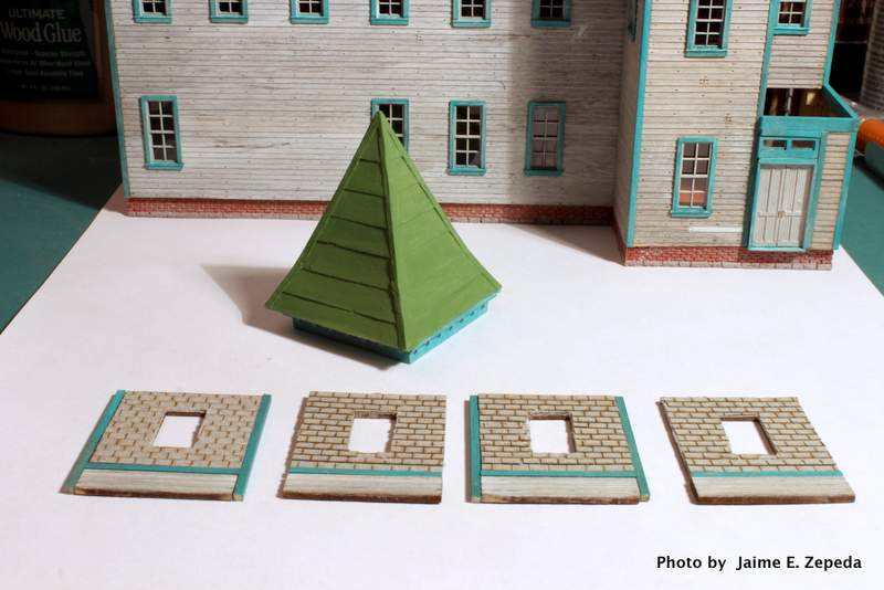

The tower is made up of 4 walls. These walls are shingled with the slate shingles. These shingles are all the basic color.
The 4 walls are laser-cut chipboard forms. To the chipboard one glues the shingles as in previous steps. So, I used my chopper once again to chop me up some shingling.
The roof of the tower is a solid resin casting. The casting has sharp detail and needs to be painted a medium green color. I spray painted my casting with cheap grey spray paint and then painted with Apple Barrel Indian Green acrylic craft paint.
The instructions did not specify a green color to use. The instructions did suggest using a medium green with more blue than yellow. Well, I'm artistically challenged so I cannot tell if a green is more blue than yellow (yellow and blue make green). As luck would have it the green I chose was more yellow than blue. Oh well, it's just toy trains.
The 4 walls are trimmed with stripwood painted turquoise. There is one more architectural trim casting that goes between the tower and the roof and it gets painted turquoise as well.

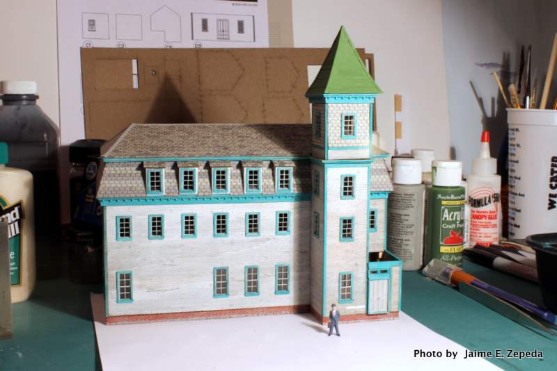

And here is the tower all ready to be mounted to the building.
By the way, Tucker has made an appearance and will be supervising the build going forward. Tucker is ready to start generating some revenue as the new year approaches. Somehow, Tucker did not get the memo that I am lazy. He will need the patience of a saint.
And here we see how the tower fits on the building.
The main building is almost done. There is only one more step to go.

Could the cupola roof be weathered copper?  The green you chose looks a bit like zinc chromate, which may well be correct for a metal roof repainted in the 50s or so.
gnatshop
Tucker looks like a certain accountant around here tryin' to make a dime off of anything he can
get his fingers in!!  ;D ;D ;D
Oh, chit - time to get seruss!!
You be doin' GOOD - this build looks fantastic!
Never knew that you were a professional roofer!   8) 8) 8) 8)
NEMMRRC
Quote from: deemery on December 28, 2014, 09:18:16 PM
The pilot model from South River does show off the tower's roof as copper with a nice patina on it. I considered buying patina paint. I seem to recall seeing it at the craft store once.
Anyway, once everything is in place I'll see about weathering the tower's roof accordingly.
