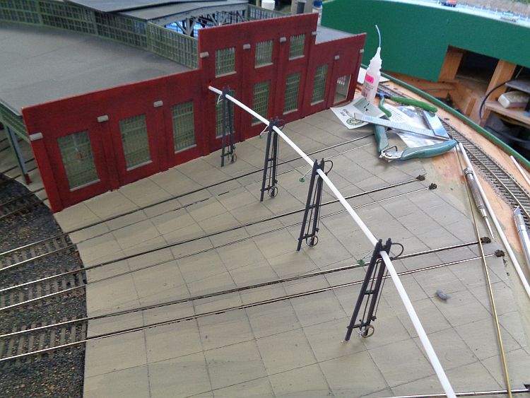

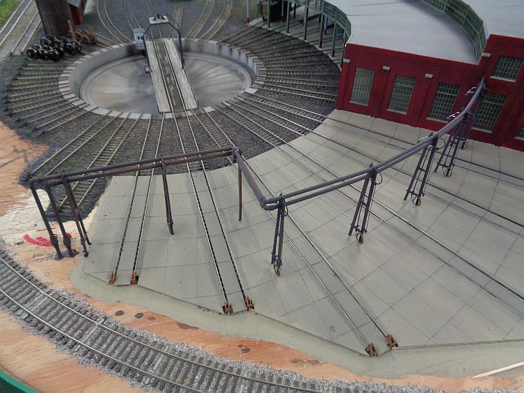

The next day I spray painted the poles with Floquil Weathered Black.

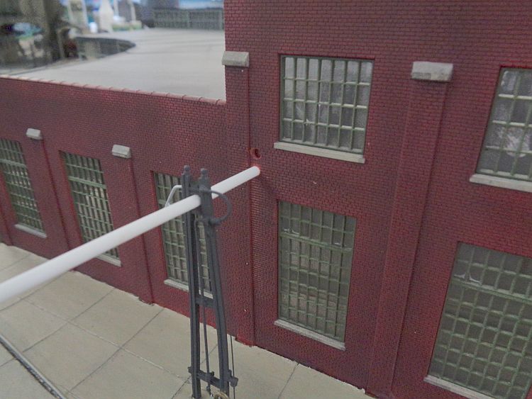

I then drilled 3/32" holes in the outside wall of the roundhouse.

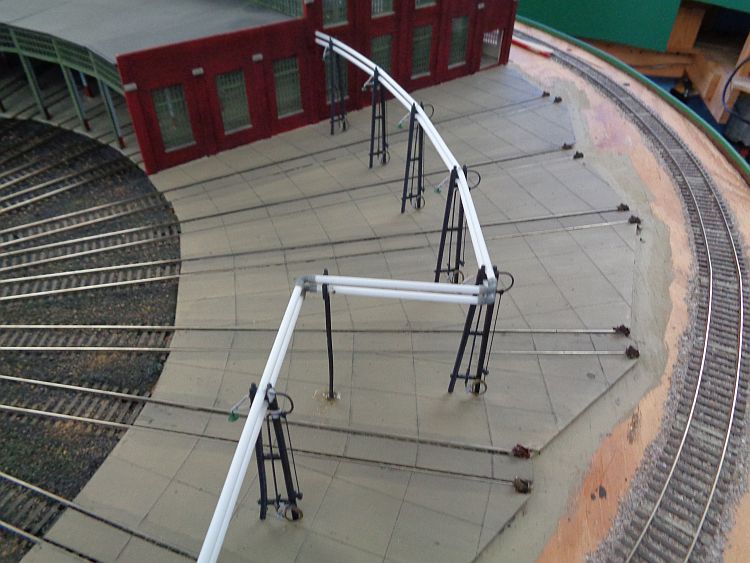

After gluing the poles in place, I started to feed the piping through the utility poles.

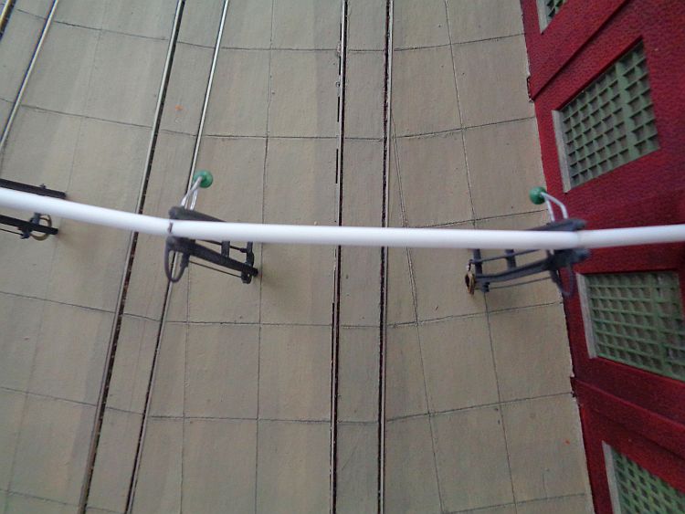

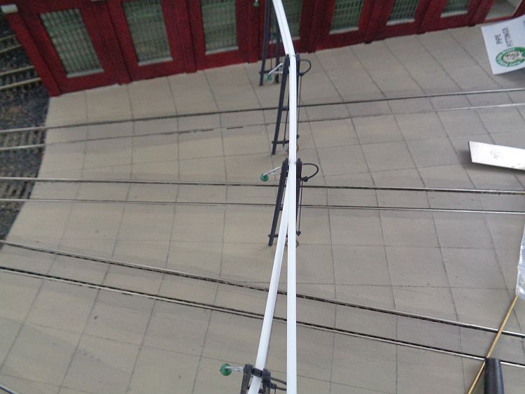

For the piping on the top of the pole, I made black marks on the tubing. I then removed the piping and and gently bent it to fit the correct angle. The piping was then replaced on the poles and a drop of ACC was used to glue the pipe in place.

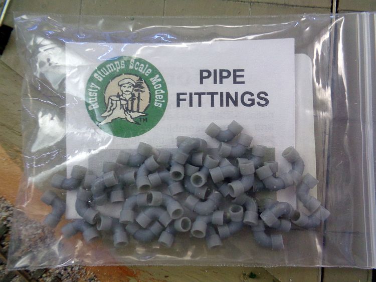

I purchased 3/32" pipe fittings from Rusty Stumps Models. I got straight, 90 degree and 45 degree fittings.

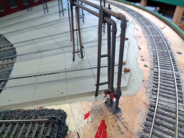

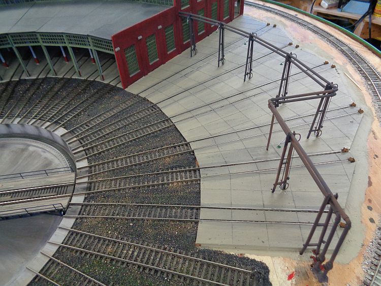

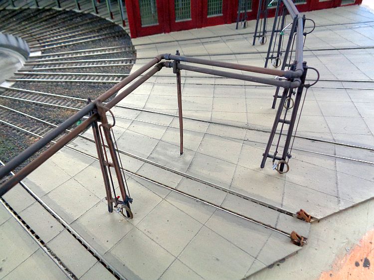

Fast forward and I hand painted the steam pipes and used pastels to add the rust on the pipes.
The large valves are also made by Rusty Stumps.
Good stuff! Walt is talking about re-opening Rusty Stumps on a limited basis. He's 83 now.
Tom, everything looks exactly the way it should.
Well done!

The yard is really coming together now Tom.  The jog in the steam pipes really adds a lot of character to the scene.

As usual, amazing work Tom.  I didn't even know you could order those pipe fitting parts.  Any idea where you might get those today?
