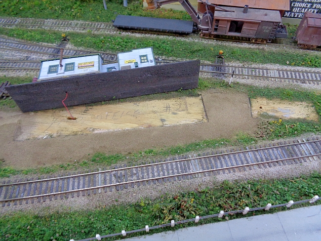

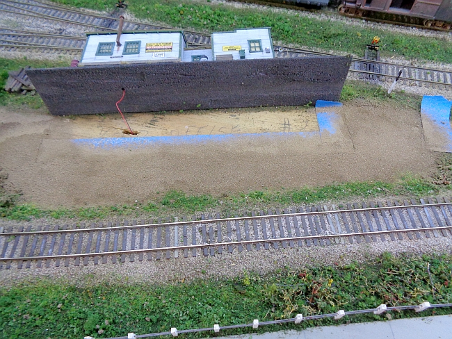

This is how it looks after the "sieve treatment".
While that was drying, I went back and fixed the other wet stained area.
I forgot to mention if you need to add a little more dirt from the sieve to cover a wet spot, do it while the matte medium is soaking up the sieved dirt.

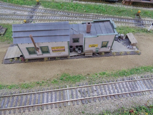

Once it was all dry, about six hours later, I removed the blue tape and had a nice fine line so the structures would fit flat when replaced.

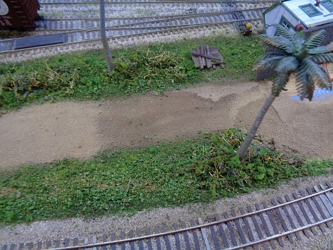

You can see the stark separation from the structure base and the new dirt road.

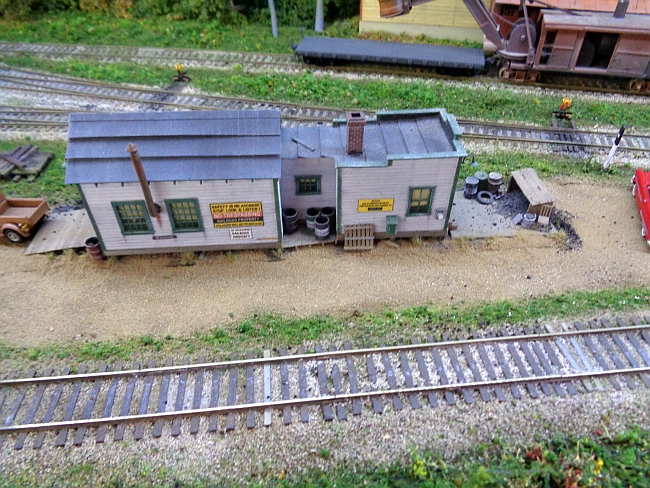

I used the soft brush to blend the dirt into the base as shown below.
There are many steps in the making of a natural looking dirt road, but the result is worth the effort.

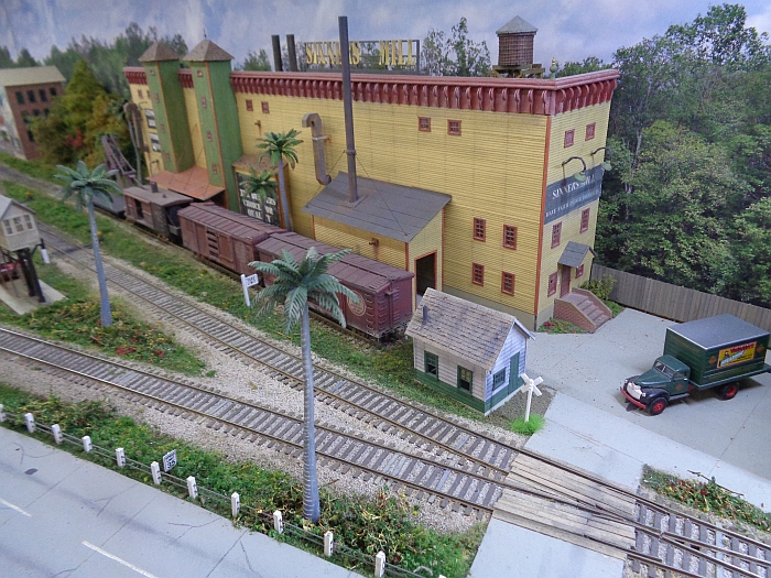

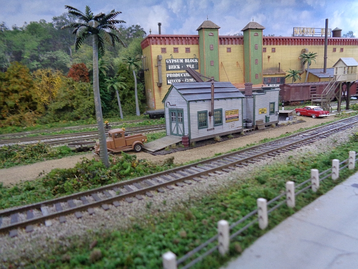

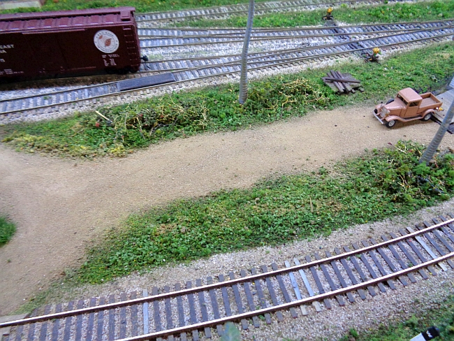

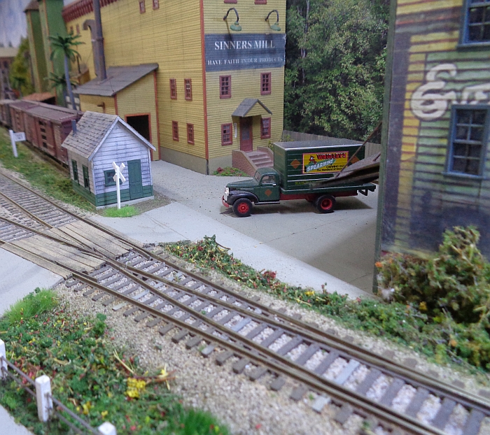

Here are a few bonus photos of the last area where scenery was added.
Tom, after you brush/push the dirt under the structure, do you secure it, or is that left loose/unglued?
Quote from: deemery on September 15, 2025, 05:05:44 PMTom, after you brush/push the dirt under the structure, do you secure it, or is that left loose/unglued?
I leave it loose as it may be necessary to remove the structure later.
It can be glued/secured, but not worth the hassle when removing the office once glued.
